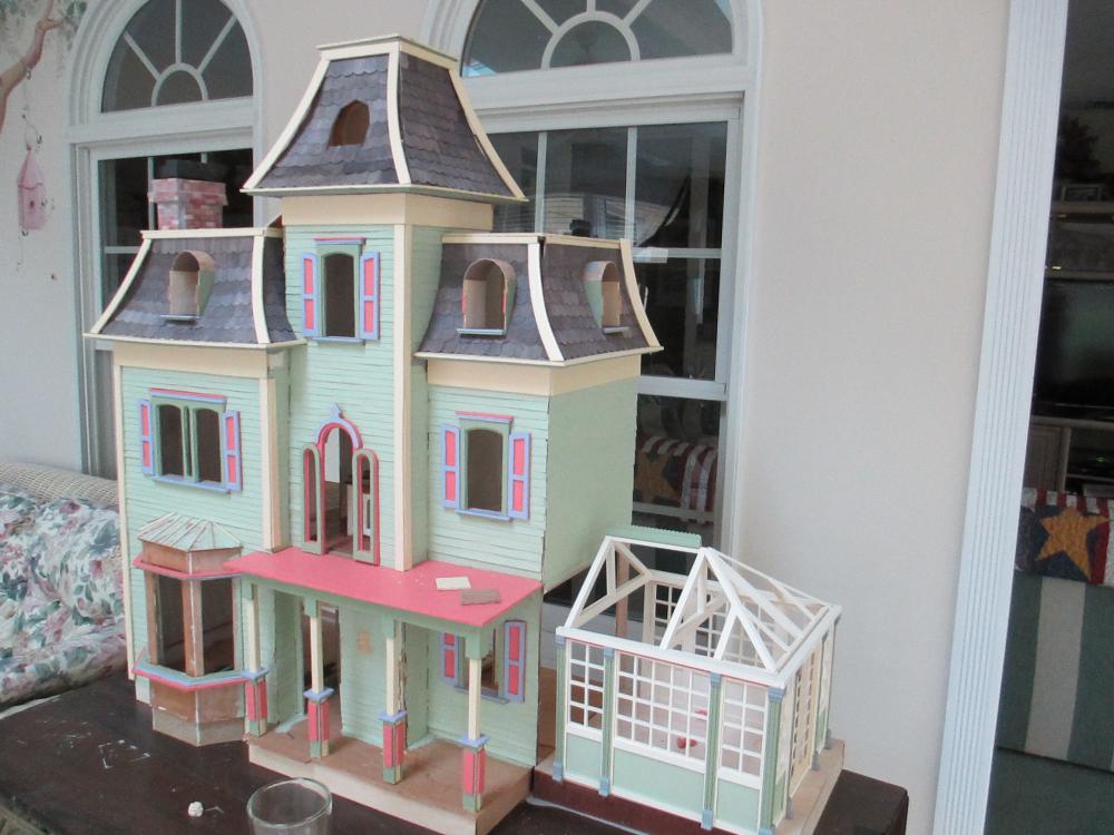

clairevc Posted January 1, 2016 Author Share Posted January 1, 2016 Quote Link to comment Share on other sites More sharing options...
rodentraiser Posted January 1, 2016 Share Posted January 1, 2016 Oh, that is a beautiful house! I'm a little concerned about all the bare wood I see though. Did you prime the house on the inside? 1 Quote Link to comment Share on other sites More sharing options...
RockawayRose Posted January 2, 2016 Share Posted January 2, 2016 That is a gorgeous house and you have painted it beautifully! Pm me and we can exchange info. You can also contact me through my blog: http://rockawayrosedollhouse.blogspot.com 1 Quote Link to comment Share on other sites More sharing options...
