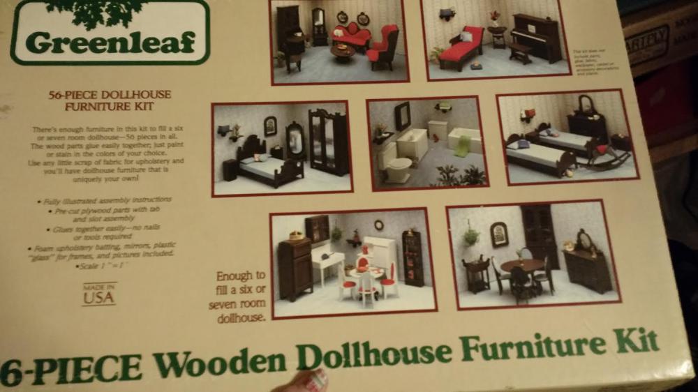

tlb5000 Posted December 29, 2015 Share Posted December 29, 2015 Newbie here. I've tried searching online and these forums, and I'm giving myself a headache. So forgive me if this has been asked before. I recently picked up this furniture kit to go along with a dollhouse I plan on building. In the paperwork is says to use a "good quality satin finish latex house paint." I am on a budget (almost all is being devoted to the actual dollhouse), and don't plan on these pieces being the permanent furniture for the house. Most of it I plan to stain, but a few I would like to paint. Just until I save up for better furniture, would I be able to use an acrylic craft paint on these pieces? Thank you in advance for your advice and feedback! 1 Quote Link to comment Share on other sites More sharing options...
parisbabe Posted December 29, 2015 Share Posted December 29, 2015 I used craft paint on mine and it was fine. If your worried about wear, use some sealant on it after you paint. Some of these pieces you can tweek with some fabric like upholstering the headboard and chair seats and the plastic pieces, you can use tester brand paints. 1 Quote Link to comment Share on other sites More sharing options...
JustCallMeAnna Posted December 29, 2015 Share Posted December 29, 2015 I used craft paints on the furniture kits that I sent along with the houses I donated. Sanded between coats and sealed them. My mother recently found my old dollhouse furniture from 20+ years ago. The kit pieces she would let me paint myself with her craft paint (she didn't bothering sealing them for obvious reasons), but the paint is still intact! 1 Quote Link to comment Share on other sites More sharing options...
Debra from Olde Cape Cod Posted December 29, 2015 Share Posted December 29, 2015 The edges of these pieces will need careful sanding and you can have quite a bit of fun with them. 1 Quote Link to comment Share on other sites More sharing options...
BriJohn Posted December 29, 2015 Share Posted December 29, 2015 I think it would be fine too especially if you bought the little bottle of satin sealer that they sell next to the acrylic paint bottles. Just my preference I guess. 1 Quote Link to comment Share on other sites More sharing options...

havanaholly Posted December 29, 2015 Share Posted December 29, 2015 You might want to invest in a can of flat white interior latex to use as a primer. Also, rubbing the rough edges with a bit of spackling compound on your finger and sanding it when it's dry will make for lovely smooth edges. Here is how some of the furniture looks, painted and upholstered: 1 Quote Link to comment Share on other sites More sharing options...
tlb5000 Posted December 29, 2015 Author Share Posted December 29, 2015 Thanks! I have a primer to use on the dollhouse. Would that work for the furniture too? Quote Link to comment Share on other sites More sharing options...
havanaholly Posted December 29, 2015 Share Posted December 29, 2015 I like to use latex paint because it's soap & water clean up, like the acrylic craft paints. I haven't been happy using oil-based house paints. Quote Link to comment Share on other sites More sharing options...
Gleise Posted December 29, 2015 Share Posted December 29, 2015 I use nail polish. It dries fast and gives a nice shine! And there are tons of colors to choose! Quote Link to comment Share on other sites More sharing options...
KathieB Posted December 29, 2015 Share Posted December 29, 2015 8 hours ago, tlb5000 said: Thanks! I have a primer to use on the dollhouse. Would that work for the furniture too? Yes. Quote Link to comment Share on other sites More sharing options...
kathi17 Posted December 29, 2015 Share Posted December 29, 2015 I use the regular craft paint for my painted furniture too. I also always buy the water based polyurethane varnish at Home Depot, and pour it into glass jars so it will keep longer. Then you have a never ending supply of finish coat. If you do that, wipe the threads of the jar off when putting the lid on. If it sticks, just run it under hot water to reopen the jar. Quote Link to comment Share on other sites More sharing options...
