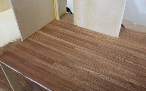

This weekend I made hardwood floors with micro veneer. I bought this stuff last year but thought it was too thin for flooring -- since the stuff has no bulk there's almost no visible seam between the strips of wood. I got the idea to go around the edge of each "board" with a Sharpie so there's a black line where the pieces meet. I'm really happy with how it turned out!
The veneer I have (purchased off eBay) cuts easily with the paper cutter for nice straight lines, and it has a sticky backing so I didn't even need to glue it. More info and photos are on my blog.
post-7-0-73363900-1427088309_thumb.jpg post-7-0-65353400-1427088206_thumb.jpg
