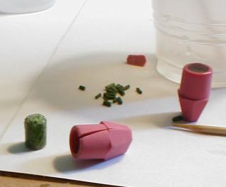

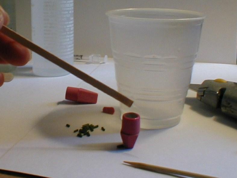

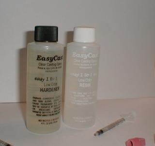

Easy Cast is a 2 part product. Take an equal amount from each bottle and mix together for 2 minutes. The equivilent of 1/2 tsp from each bottle (160 units if you have a syringe) is enough to make about 9 canning jars. I don't recommend mixing more than this at one time because by the time you fill the 9th jar, the epoxy is starting to set up a bit. Using a coffee stirer, I put a few drops of epoxy in an eraser then I add a few green beans and stir with a bamboo skewer. Make sure the beans are well coated then keep alternating epoxy, beans and stirring until the eraser is about 3/4 full. Top off with a few drops of epoxy. Set aside and let dry overnight.
