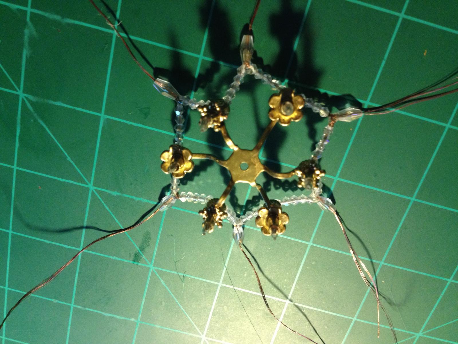

So, the biggest issue with wiring the chandelier was how to get the wires for each arm into a workable diameter. The insulated wires are too thick to thread them through the thin brass tubes, and so on.
Yesterday, when we talked in Briana's thread about the wiring for Pat's light - I had a mini epiphany: Why not use the wire like thread for beads and such? I dug out all my light fixture stuff and went at it.
So, I already showed you my adventures in soldering, here is the next part. The crystals are threaded on the insulated wire. Two for each bulb. I then stripped the wire to where the beads ended, and tied one wire from one light to the one from the next light. that gives you six combined wires. To reduce that further, you take every other wire to connect two pairs of three together. If you were to count them through you connect the even numbers together and the odd ones into a separate wire.
I used epoxy to insulate the knot I made at the junction of each pair of two and added a bead to cover it.
My next step is to use shrink tube to cover the three-wire pairings and connect them to the main wire - and to hide the junction in a bead or hollow something - I'm still digging through my stuff....
I tested the pairings I made - and it works...........

Oh my gosh - I can't wait to see what this looks like when you get it all assembled.  So you joined one wire from one to one from the light next to it, and continued to do it around the entire fixture, ending up with 6 twisted-together sets of wires.  OKAY.  Was there any particular reason you then gathered every OTHER wire instead of just the first three in one bunch and the second three in the other bunch?

Pat, you need to use every other pair to get the 6 minus and 6 plus poles bundled. (Don't know if they call it that....) Every bulb has an A and a B wire. By connecting them like I did every other wire pairing you get all the As together and all the Bs - then you take each bundle and connect it to the main wire.
I drew at least 3 diagrams to make sure that that will work.
I didn't use pre-wired bulbs, but store bought bi-pins. I just cut regular wire, widened one end a bit with a hot sewing needle and then pushed the pins into the wire - I figured that's the easiest way to do it (and I had those bulbs).Sealed and insulated with glue at the bulb bottom and covered it with a brass tube.
